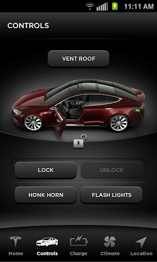

You can now access to your car (among other things) with your phone app:
https://play.google.com/store/apps/details?id=com.teslamotors.tesla&feat...
Lock / Unlock / Honk Horn / Flash Lights / Vent Roof.
