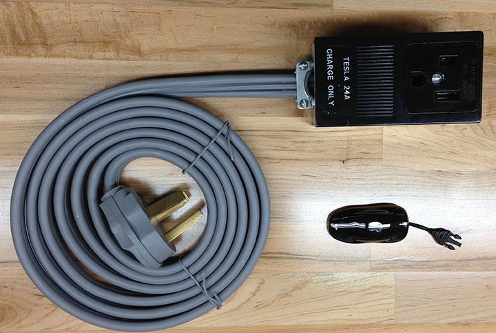

I made this from two standard parts (only tools need are a flat blade screwdriver and pliers to hold and slightly reshape the eyelets attached to the cord.
* Leviton 5378 50 Amp, 250 Volt, Surface Mounting Receptacle, Straight Blade $11.65 on amazon
* PETRA 90-1028 3-Wire Dryer Cord, 10-Foot, 30A $15.79
As noted by others (check out FlasherZ's charging FAQ) you must dial down to 80% of the circuit's rating, hence my label about 24A and Tesla Charging Only.
Works great if you use it with care. Keep the screw terminals on the 14-50 receptacle tight!

Thanks for the info, but just to avoid confusion, I searched Amazon for the Leviton 5378 and it looks like a 3 prong NEMA 6-50. The correct receptacle for the 14-50 looks to be the Leviton 55050.
hfcolvin, Looking at the pic that BrianH put up it appears that indeed it is a 6-50 connector he wired. And that would be the one easiest to wire with that dryer cord shown.
