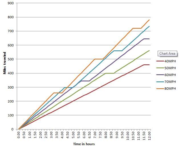

Here's my graph (if posted correctly) of distance vs. time for some continuous driving.
Assumptions: 85kWh battery, starts fully charged; simulation granularity is 15 minutes; when battery gets low, there's a fast charger right there; you spend 3/4 hour charging at 90kW.
I did a best fit on the curve shown at http://www.teslamotors.com/goelectric/efficiency and am using the formula: kW used = (.0254 R*R + .7 R + 103) where R is the rate of speed in MPH.

@ EdG, I assume that the plateau on each line (avg speed) is the charging period. Would you actually be able to go a little over 300 miles at 70mph before charging? Have I misread the graph?
EdG,
Very interesting graph, but I'm a little confused. The original poster showed that at 55 mph the Model S has a range of 321 miles. (I assume that is with aero wheels.) Your graph seems to show a range of over 300 miles without a charge at 70 mph. The Roadster, upon which your data is based, can't achieve that sort of range either at that speed.
Am I misinterpreting what the graph is displaying?
Thanks.
Larry
Good catch. I'm going to reprogram the simulation to stop for recharging at some reasonable number other than 0. I'll have it stop when getting below 10 kWh and re-post.
If anyone else sees an issue here, please let me know - I'd rather fix them all at once!
Stop whenever below 10kWh
I'm missing something, because if I'm reading the chart correctly, you're saying that you can go about 350 miles at 60 mph before the first charge. That would be nice, but it's higher than the 300 miles at 55 mph (or even 320 with aero wheels).

My charging rate is likely off. I assumed the full wattage is added, without loss, to the battery. So the charging rate is probably too fast. I picked 45 minutes of charging because Elon said it would charge to about 80% in that much time. My simulation shows close to that, so either there is little loss (??) or the wattage of the high speed charging unit is rated by results, not the source (????). I don't know. I just used the numbers I have. On the optimistic side, it's also possible that the car will really perform to this range, but the various numerical claims made have been very conservative.
Any tweaks to these assumptions that sound closer to reality can be added.
After said tweaks, I can do the same for a high speed 60kWh battery and lower speed charging for all sizes, if desired.
